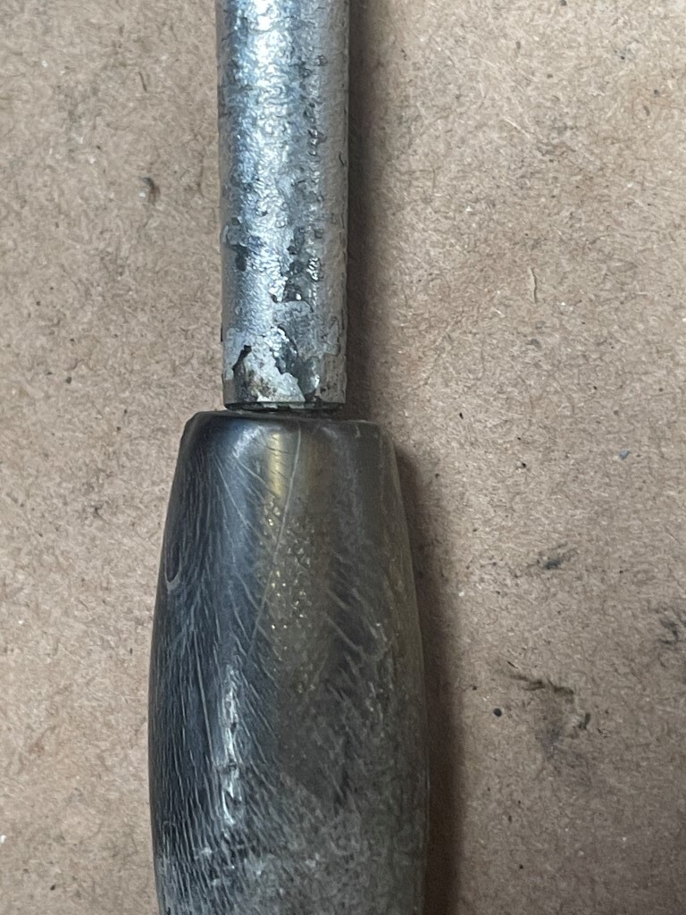

I have a brand new lever to fit to my car but the black plastic end doesn’t want to come off the old one - does anyone know how it should come off (turn, pull?). Or can i get a new one?
And how much force can i use before it’s likely to break?
I can tell from the picture that it’s been molded to the stalk. Get it really warm or destroy it right away. I think you should find a new one or make a silicone mold, epoxy copy, drill that and epoxy it onto the new stalk.
I was able to repair and refinish the original shift lever knob on our MK2 (it’s identical to the turn signal and overdrive knobs). I used my Dremel with a cut-off wheel and carefully cut a slot in the knob that ran the length of the inserted chrome shaft. That relieved the compression on the knurled end of shift lever and I was able to slide the knob off. I believe that the knob was originally molded onto the shaft which makes removal difficult. I then filled the cut line and misc. cracks with JB Weld then finish sanded the knob down to 400 grit. I spray painted the knob with gloss black spray paint and then glued the knob back onto the chrome shaft.
