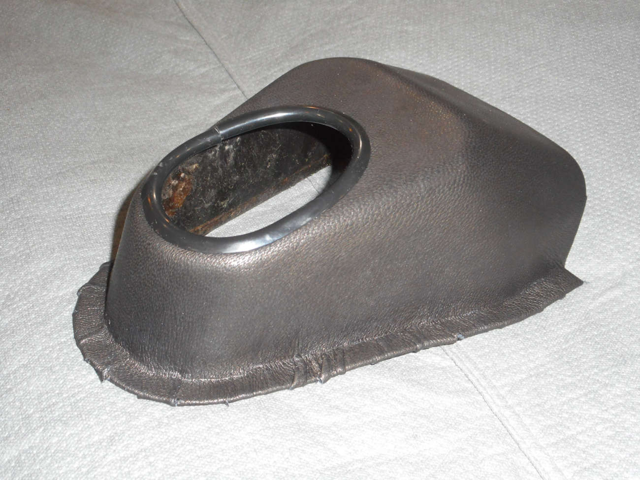

Done. The more I thought about it, the less I liked recreating the original plastic covering on this prominent area of the interior. This now looks and feels like it belongs in an upscale sports car. (I’m NOT installing a rubber gaitor either).
I searched Ebay for 2.25oz goat leather. I got enough to cover this part 5 times over for under $25.00 shipped. Goatskin has a bias to the stretch and if you work it right it can almost wrap a baseball.
No seams:
That looks really nice.
