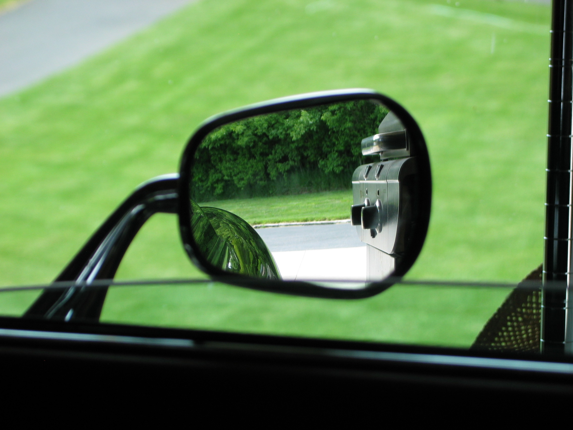

Here are some photos of what is my ‘original new’ mirror and my ‘new new’ mirror after modification. The original base has the flat mirror and the new base has a convex mirror with a black vinyl gasket around the mirror. This shows the view with the original base, hardly helpful.
Hope these are helpful. I did not think to take pictures of the bending process. I originally was going to ask them to make me some pieces on the lathe so I could try to make an adaptor.
