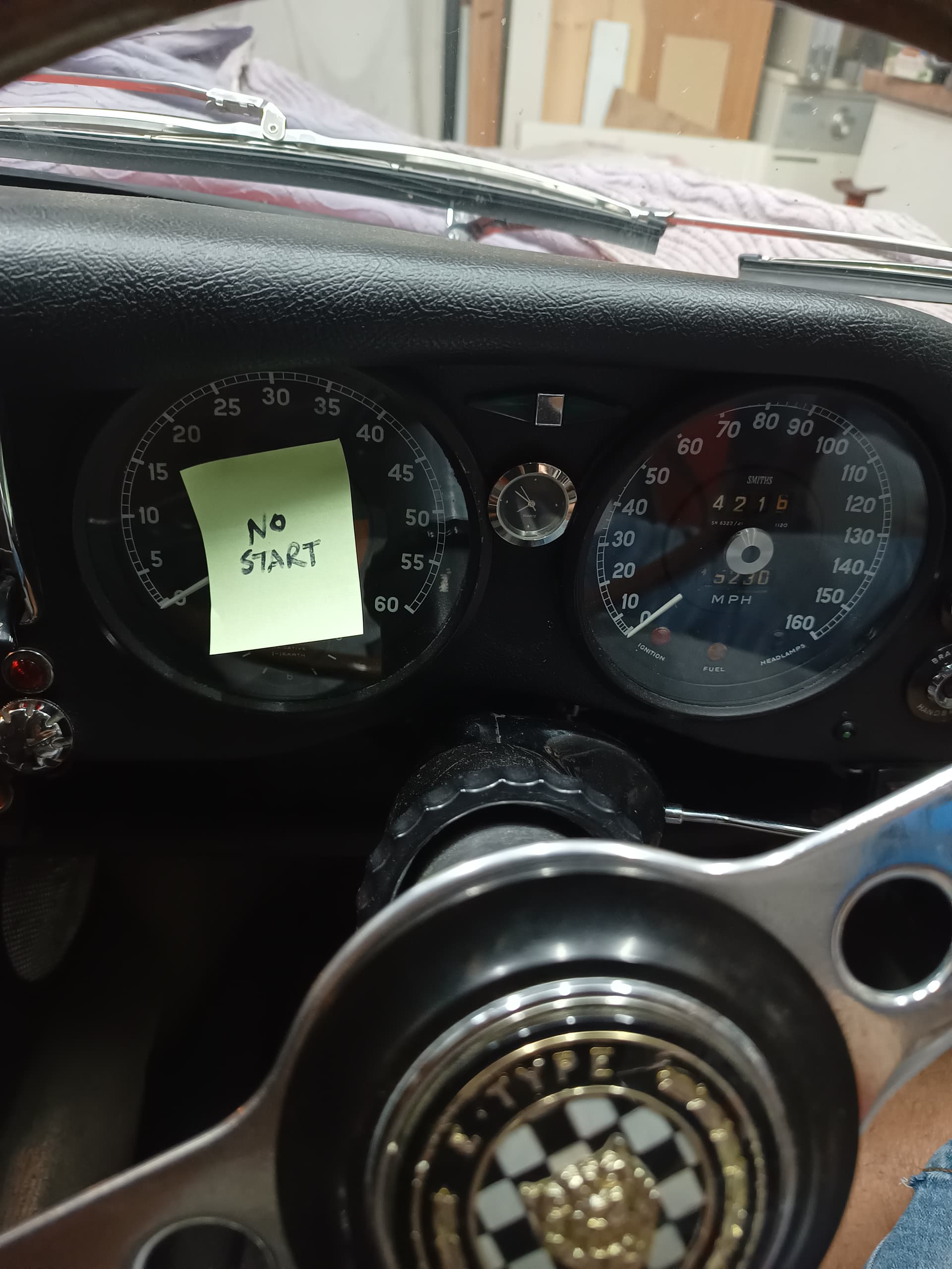

Yesterday I panicked. Driving home after a day of visiting relatives, I was quite close to home when I noticed the oil pressure gauge showing a pressure drop.
In the garage at tickover with a hot engine the pressure was showing almost zero.
But there was plenty of oil flooding the exhaust cam, so there has not been a catastrophic crankshaft failure
Today I thought, how to test the gauge / sender? Simple. Using a spare male compressor fitting (helpfully the sender has a thread identical to a BSP thread) I plugged it into my air compressor. With 60psi into the airline the gauge read about 30-35.
Sender. It is always the sender. Quick way to test the gauge is to touch the loom connection to earth. The needle will immediately pin itself to the right past the 60 mark.
A new sender is already on its way. This will be the fourth in 20 years.
