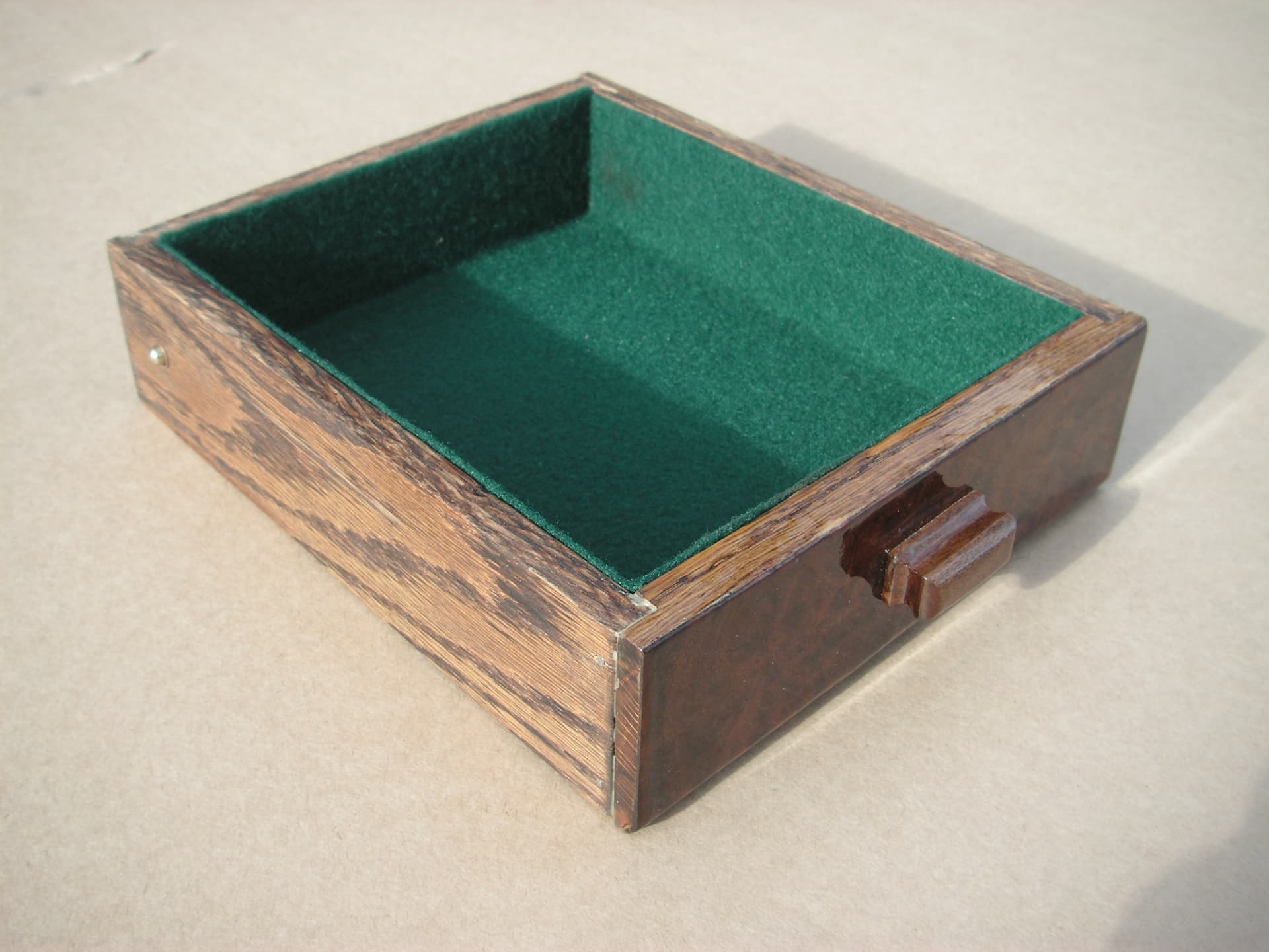

Has anyone here restored their veneer themselves?
I made my own map drawer. Early 120 FHC is different from later cars, sits in a metal tray, no brass slides.
I got the walnut veneer from Owl Lumber in Lombard IL.
The technique is you soak the sheet in water to get it soft and pliable, no wrinkles. Then use Elmer’s water based glue to lay it down. After it dries, trim off and sand. Then polyurethane. Then wet sand and polish.
Rob,
That looks amazing! I bought walnut veneer from a “local” wood shop but it didn’t match. I then found that I needed Russian walnut veneer so I ordered that from an outlet in Ohio. The grain and color are much better. Per a Jaguar veneer restoration posting on the web, I’ve made up a mixture of water, alcohol and glycerin and wetted the veneer then placed clean paper and weighted plywood on top. It has come out flat, wrinkle free and quite playable. I have the wood pieces ready to veneer but am still not sure which glue to use. I purchased some hide glue but now see that Tight Bond has a veneer glue. I’m going to research that a bit.
