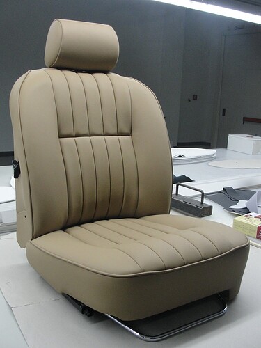

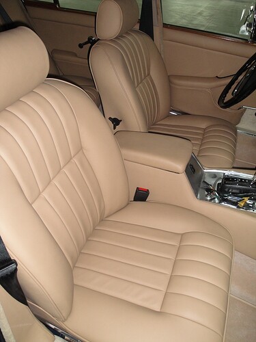

As I am rather tall, I have installed Series 3 front seats as they are significantly higher and have a solid headrest.
Perfect seating, although I have to say that the original seats were comfortable too.
Disadvantage: The Series 3 seats steal a little bit of the SWB legroom.
Maybe early XJ-S seats could be an alternative - they are thin AND comfortable.
Back height and headrest are the same as series 1?
They are deeper and might sit higher. The lumbar adjustment is nice, the added depth isn’t.
I would guess that the backrest is 5-6 cm higher than the originals.
I thought they both ended at the bottom of the windows but if you say so!
Although, if these are seats with the height adjustment, the motor and mechanism would add those 5-6 cm :thinking:
I like your seatbelts. If you don’t mind, could you tell me how you mounted them? I have a similar arrangement.
My Jag is still in hibernation, but I will make some pictures about seat belts and measure the differences.
Remarks: I have lowered the seat rails, and there is nothing left from height adjustment mechanism - at least my bottom frame is similar to Series 1. so finally, I am sitting lower, and although Sir William‘s „window line“ law is followed, my shoulders are covered better.
