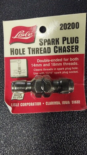

I realize this is an older thread, but I have the same problem with my Mk 2’s 3.4l engine. A web search turned up this product: https://www.sealey.co.uk/product/5637192178/14mm-reverse-action-spark-plug-thread-chaser
Does that look right? I happen to be in England at the moment and noticed there’s a location not far from me that should carry this product. (Will call in the morning.)
Rick
The reverse action sounds great!
Somewhere in my pile of tools, I have one of those! It’s quite a handy tool, and you’ll still need to use a little light Grease on it when you use it.
Even cheaper on ebay, $6.
I’ve used the 14mm end many times. Used the 18mm end once on a 1928 Dodge back in 1969.
Thanks for the replies. Checked the websites of several of the nearest suppliers, and none list the Sealey product. Will check what’s online when I get back (the eBay shipping price seemed quite high).
The Sealey product looks very different from the Lisle product. I can assume they work the same?
Reverse chaser at Amazon’
