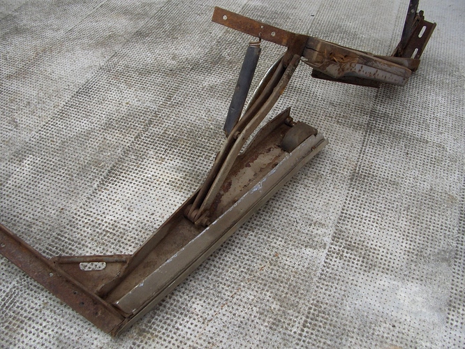

I am in the process of reassembling the hood frame on my 120DHC after dismantling to bead blast and paint.
Silly me has forgotten how to reassemble the 2 haf round rubber blocks mounted on cantrail arms and the springs inside plastic tubes that go from this to the centre bow - can anyone provide a photos of this area?
terry
thanks I had guessed this bit but all adds up nicely
