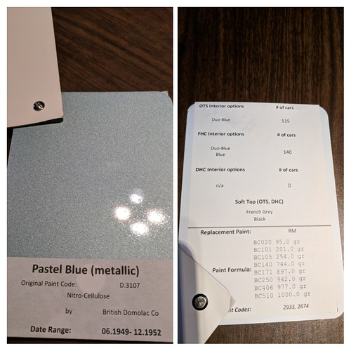

Wonderful dialogue.
May I please have an update on where to find a reference for finding how to re-create the as near original Pastel Blue as possible, eg a modern paint code equivalent (? Max Meyer, ? Duralit, ? Spieshecker or any other).
Our car was repainted white so well that there is no trace of the original inside or out to sample.
Simon
Early cars were Pastel Blue Metallic and later cars were Pastel Blue without the metallic. Give us the body number and we can figure out which for yours.
For the synthetic lacquer era we could look in Clausager’s XK120 book at the paint records, which lists only one DHC in Bronze, one late OTS in metallic blue, and no others in metallics at all that would be identified as built in the post-cellulose-enamel era.
OTS and FHC of course cross over the boundary, and this record does not delineate if and/or whether any of the metallics listed were done in the later period.
Clausager states specifically that the six metallics were deleted between Oct and Nov '52. If any had continued to be offered as a special, I think he would have mentioned it, as his purpose as a historian was to identify the color history as best he could determine from the records.
