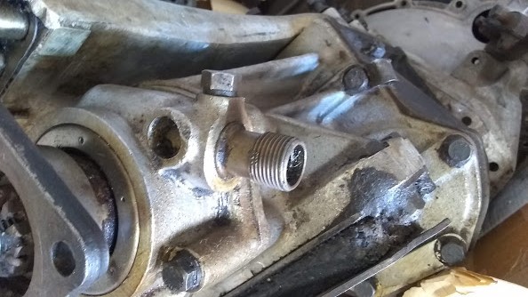

My 1954 XK120 speedometer was not working. So I unscrewed the wire from the meter, pulled the cable from the sheath and found it broken off. I tried to unscrew the transmission end of the wire without success. there is no grip for me to unscrew. I need help in how to remove the lower end of the broken speedometer rotating wire. Also where can I buy a replacement speedometer wire?

The little end and the big end are pretty similar. Use pliers on it.
Last time I bought one was from Moss Motors. XKS Unlimited may have them.
thanks Rob. The pics help. Just want to know I was doing the right thing if I am going to use force.
I used some pliers with some leather to prevent the ring from being scratched up.
