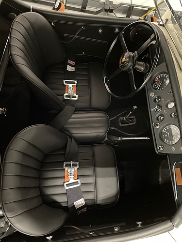

Reporting back that I went ahead and ordered the bucket seats from Classic Quality in the UK. They arrived in perfect shape about 6 weeks later. Very happy with the quality and customer service. The backs are a little too upright for my taste so I’m going to experiment with a spacer in the front or a pivot extension of some type. Only fabrication needed was matching and drilling the 4 holes to fit my existing sliders.
Here’s what they look like installed.
Looks very very nice! Regarding the back rest angle: have you installed the wooden wedges under the seat (rails) to tilt the complete seat? This was done on many XKs.

Hi Bob,
I’ve tried putting a 1/2” spacer under the front of the frame but it was not sufficient to make a noticeable difference. I’d be interested in learning measurements and methods regarding wedges (or any other methods used).
As far as arm and leg space I had to move the seat forward quite a bit to properly reach the pedals so considering I had the original seats back against the hood that should mean more leg space (but remember that I have an XK140 which has more leg room to begin with vs. your XK120). Since the back of the bucket is thinner than the original seats I would think you would sit further away from the dash/pedals.
I have not noticed any additional arm room. It is a little harder to snake myself under the steering wheel (stock wheel) but I attribute that to the much larger bolsters on the side of the seat. Of course the lateral support that results is the main advantage of the bucket seats.
Chet

Having one of the very few genuine XK120/140 surviving sets of these factory bucket seats and having made several dozens sets it is always disappointing to see the poor replicas manufactured elsewhere and then trimmed incorrectly. Made correctly trimmed properly bolted to the floor or hinge and adjusters they need no tilt or otherwise! terry

Thanks for your detailed response! However I’m not quite sure what is so disappointing about the trim on the seats I chose? I was not striving for originality but simply wanted a bucket seat that provided more lateral support when driving my XK140 and I’m very happy with the quality and trim of the ones that I bought (keeping my original “bench” seats for reinstalling should I ever want to return my car back to “as built” condition). I certainly like the original look of those seats but got tired of the lack of lateral support when driving the car - hence the bucket seat purchase.
I tend to like a more severe recline to the back of a bucket seat than what was standard for the era because I have a lower back that does not like it very much when the seat back is too upright. It may be that someone else whose back is not so sensitive would be completely satisfied with the recline of the seats I installed.
In fact I wrestled with the upright nature of the (original) seat in my 1959 Austin Healey 100-6 until I found a shop that could weld in a higher pivot point that allowed the seat back to recline more and made it a LOT more comfortable for me when driving my Healey. In that regard I’m not quite sure if the recline of the backs of the original seats you reference here would be ok or not but I was more worried about having a seat that would not rotate forward for access to the hood (especially since I would be buying it sight unseen and figuring that I could make some changes if needed once I actually had the seats installed in my car). I assume that even though being bolted to the floor your seats do permit access to the hood?

“disappointing about the trim on the seats”
The style of trim the competition seats weren’t pleated at all, all 4 pics of trimmed seats shows correct style.
From what
I can see of your seats apart from backs looking to be almost vertical they seem to lack the hip supports pieces as per my photos?
terry
