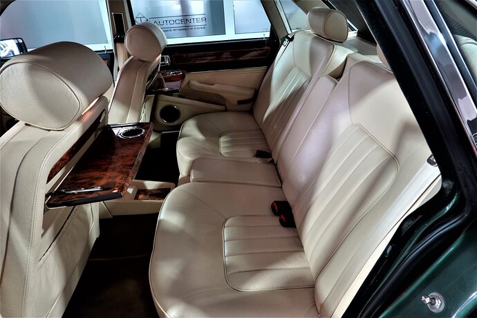

Here’s some picture when I bought the car last year :
