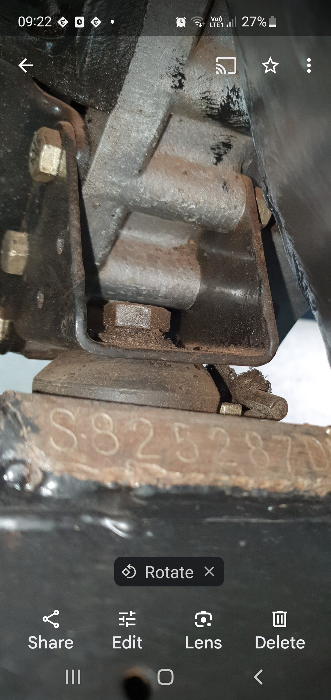

Hi Andrew…the S is for a Special epuipment model (SE) i think…here is a photo of my chassis number…its a rhd fhc 1960 next to the left side engine mount by the bellhouseing
