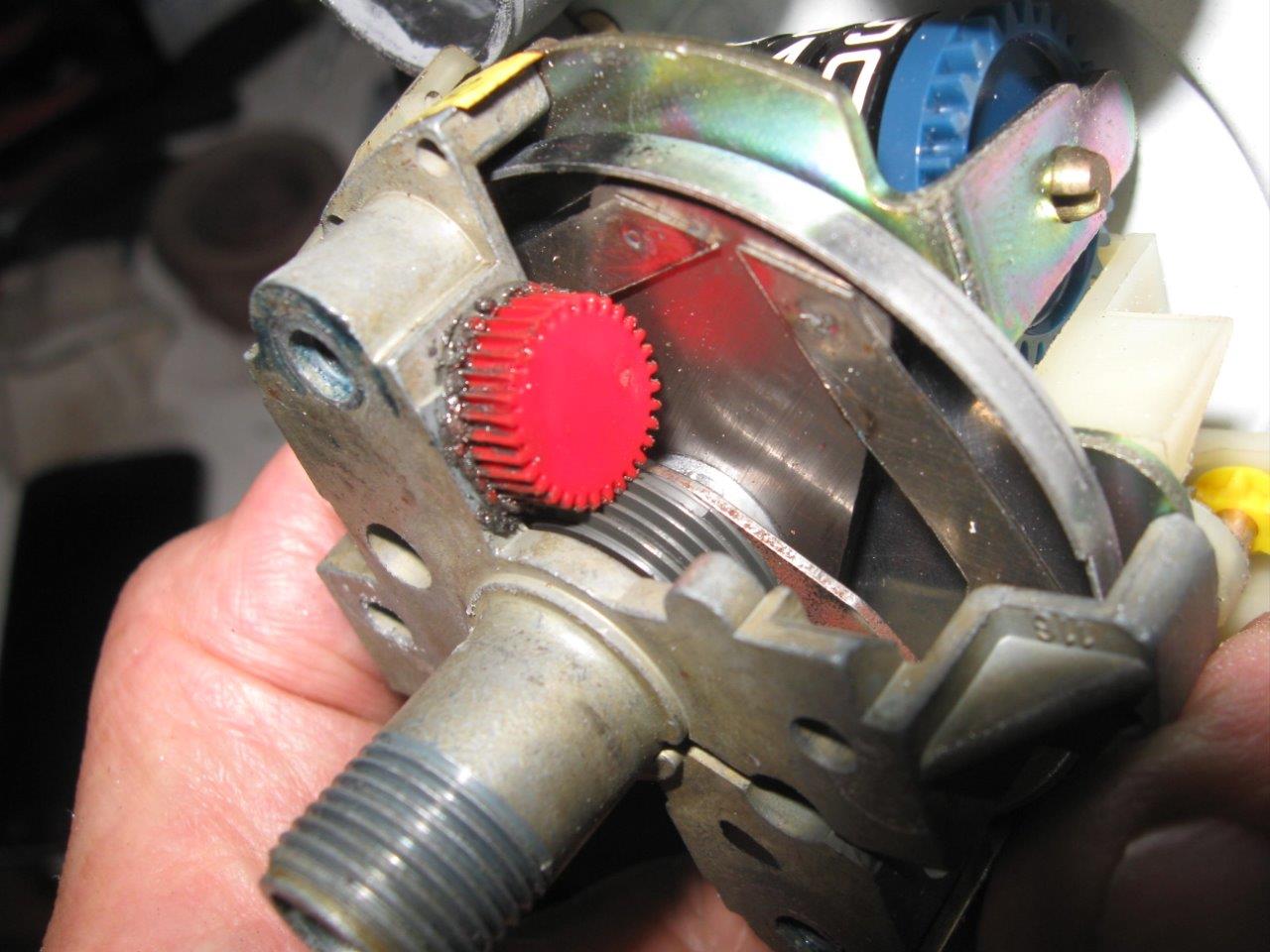

Hi, The odometers in the speedometer of my 1973 E-Type don’t work, I took it apart and found a red plastic gear with a flat spot. It drives a shaft with an offset peg on it’s end that operates the little arm that indexes the gear on the odometer wheel to increment the miles. The red gear’s shaft was glued in it’s bore from dried lube. Anyone know where it’s possible to get the red gear and it’s attached shaft ?

It has 32 teeth, measurements according to my eyes and micrometer are:
OD of the red gear is about 0.435 inches, OD of the shaft is 0.197, total length including the shaft and offset peg is 0.868, thickness of the red gear is about 0.171.
Not to be cheeky but I found there was no spring holding the white plastic arm against the odometer gear. The arm has a big hook on it’s bottom in the attached photo that I thought would attach a spring. Do you know if there is supposed to be a spring there ?
Hi Steve, I tracked down the gear and shaft. As for the spring I think there should be some sort of mechanism (spring?) to hold the pawn against the gear. The speedo appears to be more modern than the ones I usually work on so I will need the p/n from the speedo face so that I can find one in my stash and look at its return mechanism. I do have a bunch of springs so I may be able to find a suitable one. $30 USD for the gear including postage (Iwill need your address) and including the spring. Cheers, Hugh

I had a similar, but not quite the same, issue with the gears in my speedo. There are two of them, one for each of the odometers, and both had cracked, causing an erratic needle. Morris Mintz at West Valley Instruments, who has done great work for me on a couple of gauges, has the gears but will not sell them - I asked, and quite understandably he declined - his bread and butter is rebuilding gauges and those gears are not exactly easy to come by. In my case I inquired about alternative sources in this forum and fellow llster @gbrinker generously sent me a couple of spares he had, gratis. That was 10 years ago (and still working great, Gary. Thanks again!)
You’d best be advised to figure out and address whatever it was that caused that gear to fail. In my case it was dirt in the gauge.
In conclusion to this topic I got the red gear from Hugh, who lived nearby and we met at a car show. I have installed it and it is wonderful to see those odometers tick over again !! Thanks again Hugh who has an excellent stock of gauges and spare parts.
