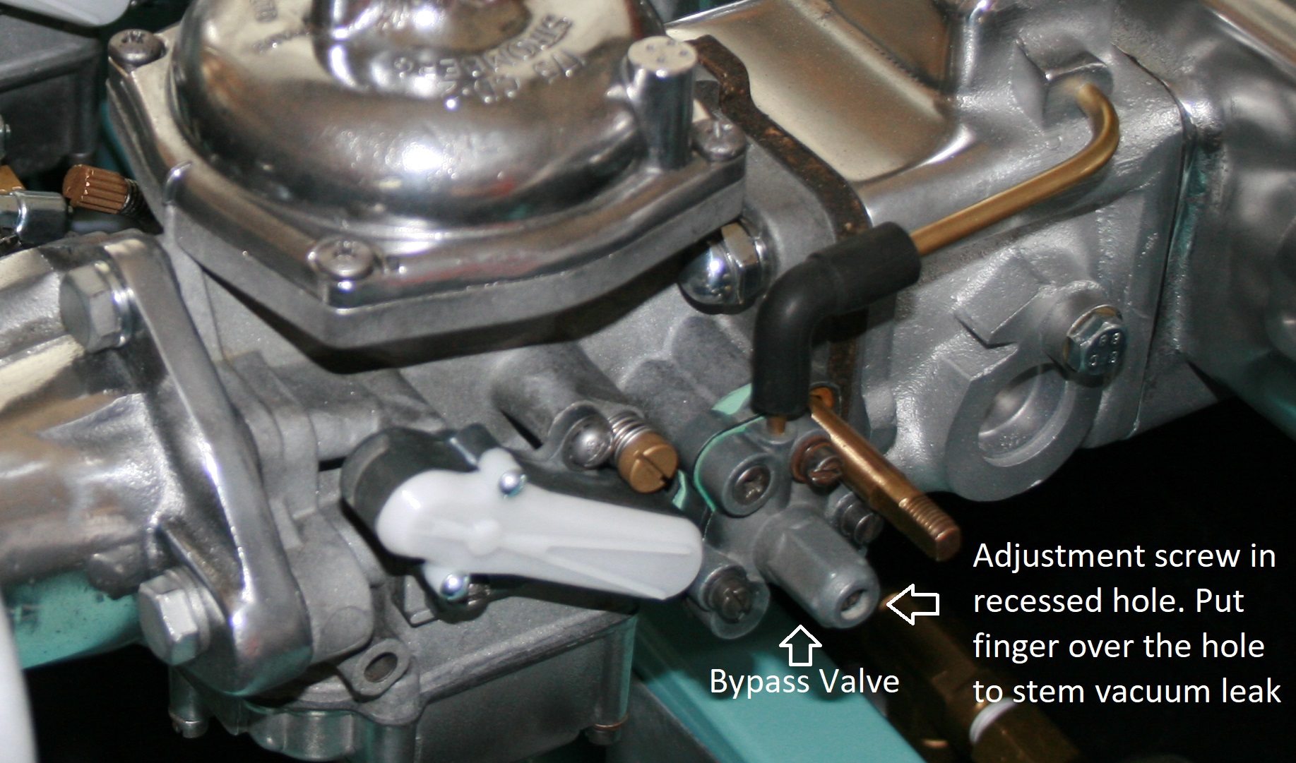

That surprised me. I thought the S1.5s only had the bypass valve on the front carb. This is the bypass valve:
Note that on S1.5 cars (as far as I’m aware), it senses inlet manifold vacuum by the external brass pipe in the top LH side of the photo. If manifold vacuum exceeds a certain amount (as determined by the screw agjustment on the spring), the vale opens and air/fuel mixture is drawn from the mixing chamber inboard of the jet and through a passgeway that bypasses the closed throttle plate directly into the manifold opening:
There is no hole in the intake carb flange that leads to the bypass valve. There is, however, one that leads to the Temperature Compensator which is another device altogether - it is the one with the white plastic cover which is fitted on both carbs. Are you perhaps getting them confused? If so, your bypass valve(s) may not be closed. Do yours have an external screw adjustment as shown in my photo. If you turn the screw all the way in one direction it will close the valve - unfortunately, I can’t recall which direction, but maybe someone else reading this can?

neither has the brass pipe shown in your picture. Air gets to by pass valve from hole in mixing chamber. Obviously I was wrong about air from.hole in flange.
