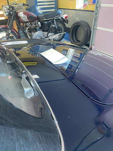

When I rebuilt my system I filled with Dot 5.1 in the mistaken belief that it wouldnt chew paint, how wrong I was, not the same as Dot 5. I’ve read that Dot 5 can be detrimental to seals in the long run, anyone had long term experience using Dot 5?

I won’t take the bait but I feel Randall’s pain took my car apart to fix that screw up . Conventional Brake fluid will eat polyurethane paint given enough time

How do you intend to repair the paint: sanding and local spraying?
Thanks guys, yeah that’s all I can do. I’ll remove as much as I can around there, data plate, fuel lines, air filter & plenum & clean & sand best I can.
