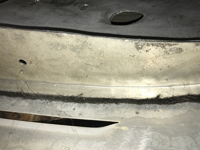

I have just finished removing several layers of paint from my 140’s bonnet with paintstripper. I noted the remains of a 1" wide strip of black felt between the rear brace and the skin of the bonnet, which has definitely seen better days. I have removed this, but presume it’s there to stop a rattle between the brace and the bonnet. What have folk used to replace this, and how do you suggest getting it into the gap, please?

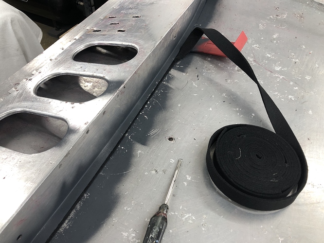

The felt’s back in now - I sprayed a little etch primer onto the skin and brace, and worked the new strip in with a thin screwdriver having opened up the gap very carefully with a wide plastic trim tool. No marking on the aluminium, and the felt’s not going anywhere.
Pretty sure it’s real felt - it shreds easily, and doesn’t feel synthetic.
I decided to fit it before paint, as the original strip was covered in top coat so was presumably fitted before paint, and fitting it after paint would probably have scratched the finish.
