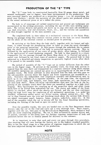

I do not think that statement is quite correct. The cars were probably rustproofed as well as any of their contemporaries. When restoring one you will notice numerous drain holes that were used for the dipping procedure as well as fluid lines on panels showing the level to which they were dipped. Being constructed of multiple box sections is likely the main contributor to corrosion.
Exactly. As can be seen in this factory description of the manufacturing process (4th paragraph), Jaguar did pay attention to rustproofing, with what were industry practices at that time. Corrosion science has come a long way since then, but at the time pretty much all cars were very susceptible, and being the first to use monocoque techniques likely exaggerated the problem with Jaguar.

That thar new-fangled “CO2 wire welding” seems promising…
I will have to come up to speed on that one. I use an argon mix,and I think the rest is CO2

Reading about the method of assembly, I’m wondering why this method isn’t used by restorers today. Separate the frame. Build up the engine, transmission and front suspension on the rails, then bolt the whole shebang to the front of the tub as a unit. You could even install the front exhaust pipes with plenty of room to work. It seems like it would save many hours of fettling. A simple wooden jig to support it and roll it around, and you wouldn’t even need a crane or jack.
IIRC, that’s how Jaguar did the E.
Perhaps one reason is that the factory had the advantage of every single part sitting there, all shiny new, ready to go, while restorers are juggling the availability from a very different supply chain.
Engines may be off being rebuilt and waiting on out-of-stock pistons, while chrome is tied up in a 3 month backlog by the plater, and the body shop just lost their only person who worked with lead, and they just found they have to redo all the bullet connections on the wire harness. All while also trying to juggle restorations on a half dozen other cars of varying makes and deal with customers whose cars need servicing. They need to assemble whatever they can as they go to keep the whole shop team working.
Bullet leads should never be soldered, but I’ll never win that argument here. Just had to say it. Every time I hear about soldering harness connectors, I cringe.
I find this unconvincing. Jigging the frame and then installing the parts to the rails as they become available doesn’t take more time, it takes less. Think of the effort of dropping the engine into the car with a crane vs slipping the frame around the engine, then bolting the frame to the body when it comes back from paint. Simpler, less time, less stress. In fact, the frames can be sprayed up long before the balance of the body is finished, allowing bodywork to proceed while the mechanicals are built up.
I choosing to in my next project to “fit up “ the firewall including brake lines etc … roll the engine and gearbox with clutch piping, , speedo cable etc in position… build the frames around the engine in situ add suspension etc.
This was recommended as a way to avoid a lot of hassle by a chap that rebuilds many many e types in his shop.
This is all done after painting and fitting and gapping of all body panels … just remove bonnet and frames and replace when all under bonnet work done.
