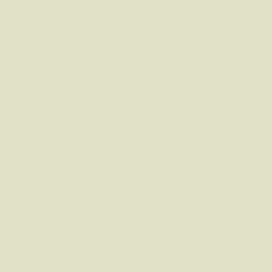

I narrowed it down to what I think it might be on the RAL charts:
My feeling is that the last one, RAL7032 pebble grey, is the most likely match for the scraps on my frames. No other RALs look to come close.
