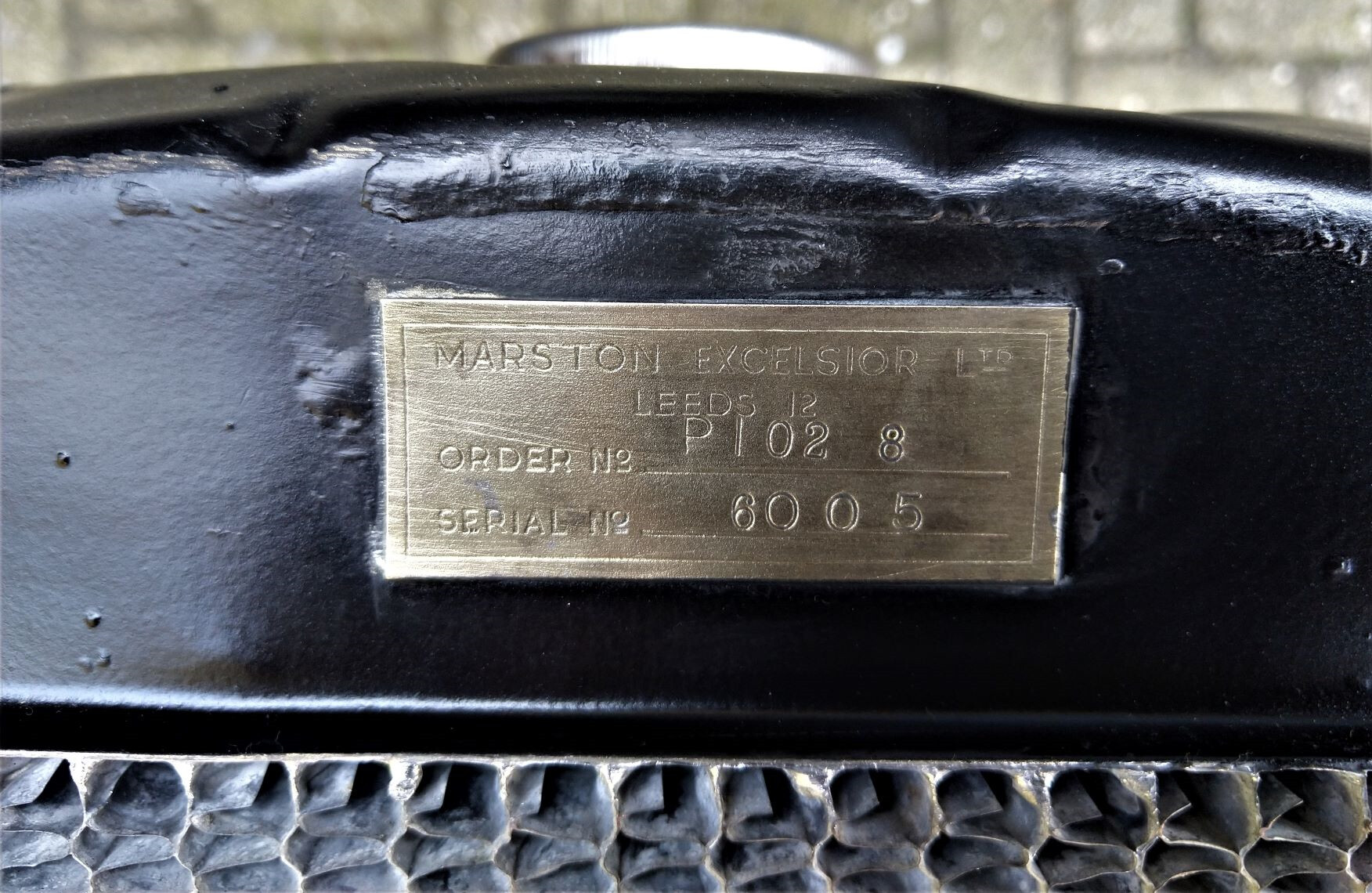

Chris,
Do you still have the “Marston Plate” soldered at the front of the radiator? I keep track of these numbers.
For the XK 120:
Order number P102 followed by a figure (2 to 21)
Serial number (from 1 to 12000)
There were some exceptions for the first 200 built cars.
Bob K.

Kevin,
I’ve seen a lot of Marston Plates but this one is really “unique”.
The XK 120 had 2 different plates but both always have the text Marston Excelsior Ltd . See photo.
Yours looks more like the one used on the first XK 140 production but these had the MEL logo including the text Marston Excelsior Ltd. See photo.
The “problem” is that yours only reads Marston which would go back to the 1930s or the first WW2 years. Also the (9 figure?) ordernummer is totally different and clearly stamped by hand at a later stage. Best I can come up with is that this possibly is some kind of repair label.
The serial number runs more or less in line with the XK 120 chassis numbers. It’s difficult to read but is that 3466? If that’s the number indeed than has your XK 120 been built late 1951 or early 1952?
Bob K.
Very interesting feed back Bob thank you, the number on the tag is 3466, my cars date of manufacture was May 11 1951 date of dispatch May 30 1951.
Kevin
Kevin,
So your Marston plate will remain a secret (for ever?). The serial number on the original Marston Excelsior plate on your May 1951 radiator would have been below 1000.
Bob K.

Bob, My plate is missing. I’ll get a plate soon. Can you give me a range for the numbers for March, '53? I’ll have to pick a number at random, but I’d like to be close.
Mitchell,
See the applicable 1953 section of my tabel. The tabel shows the chassis numbers I have for that period. Maybe the best thing to do is to “interpolate” between the chassis numbers on basis of your own. There was no “First in, First out” system for radiators delivered by Marston on the production line meaning there is no strict logic in the serial numbering,
So most likely seems Order Number P102 9 and for the serial number you pick one somewhere between 6824 (#763342 of Dec 1952) and 7602 (#674112 of July 1953) depending of your own chassis number. .
Bob K.

Bob:
If you are maintaining a table of Marston numbers my July 1st build, 1953 DHC (#677577), carries order # P102 and Serial # 7165.
Chris.

Chris,
This is almost an “ethical” question, but I understand your concern. But on the other hand, I already encountered a lot of “illogical” number combinations that could not be matched with other (proven) combinations of chassis number and radiator number. So if anyone in the future will study the matter once more, he/she (or anything else I should add nowadays) will arrive at the same conclusion: “here was something wrong”.
Personally I think that changing a chassis or body number is more “unethical”.
Bob K.
